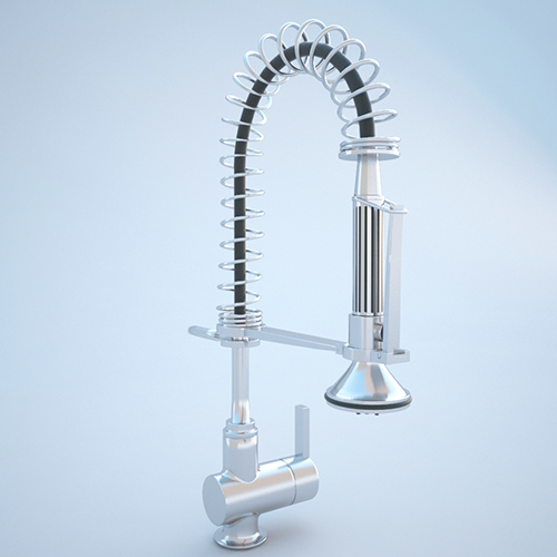

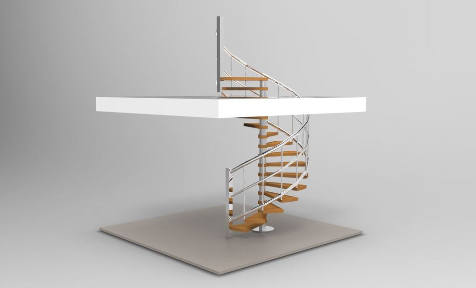

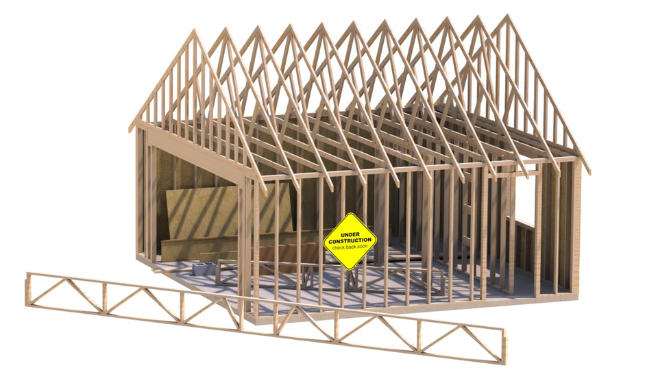

I have been developing pieces to make it happen with CADFlux 3D Visualization engine (http://www.cadflux.com/gallery) which we are developing in-house at Dixit Systems. It is in early stages but you can get a glimpse of how it works with some sample files -
1. http://www.cadflux.com/viewer?modelFile=Factory%20Framework.obj
2. http://www.cadflux.com/viewer?modelFile=Spiral%20Staircase.stl
3.http://www.cadflux.com/viewer?modelFile=Hujvik%20Faucet.obj
4.http://www.cadflux.com/viewer?modelFile=Home%20Construction%20Project.step
